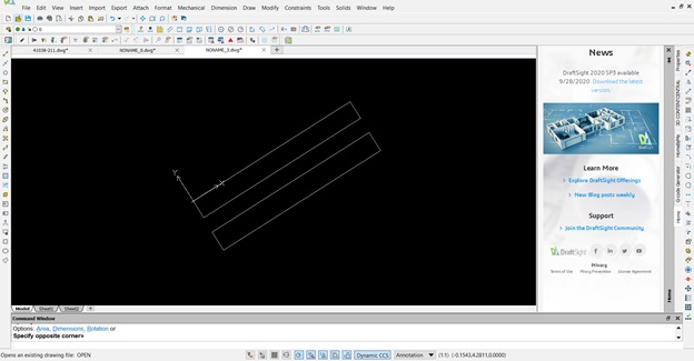

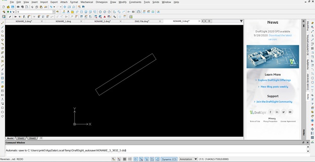

In order to understand better, let’s consider a simple example of a rotated entity as shown in screen capture below:
The steps are as follows:

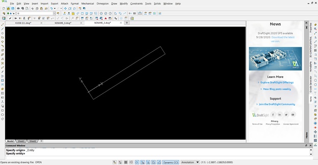

1. In the DraftSight® menu bar, click Tools > New CCS and choose the option as 3 Point (or choose “Entity” and select the entity drawn in the graphics area to align CCS with it). Then you are required to specify those 3 points.
2. Specify an origin point for the custom coordinate system.
3. Specify a point through which the positive X-axis should run.
4.Specify a point in the positive area of the XY-plane (this point needs not be located on the Y-axis).
5. As you can notice in the below screen capture that CCS is aligned to the angled entity in the drawing area.
6. Now when you modify entity or create entities, it will be aligned to current CCS as shown in the below screen capture.

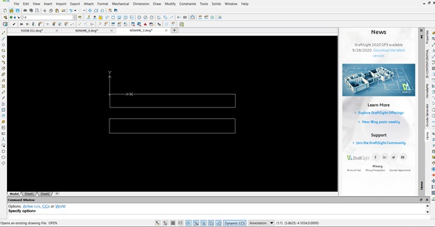

7. If you like to work with objects aligned to screen; you can set the plan view to the current coordinate system (the current construction plane) using ‘PLANVIEW’ command in DraftSight.
See below screen capture.
a. Type’ PLANVIEW’ at the command prompt.
b. Specify Option “Active ccs” to set the plan view to the active coordinate system.

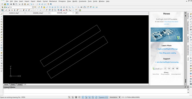

8. After editing the angled portion of your drawing; you can switch back to the Word Coordinate System, from DraftSight menu bar, click Tools > New CCS > World. Again use ‘PLANVIEW’ command to set the plan view to the current coordinate system. See the below screen capture.
