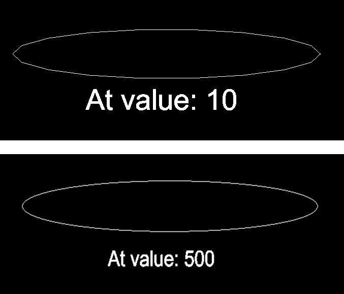

‘DISPLAYQUALITY’ command in DraftSight® controls how smooth Circles and curves are displayed in the Graphics Area. It specifies the view resolution of Circles, Arcs, Ellipses, and Splines by a circle zoom percent value. The higher the value of DISPLAYQUALITY, the smoother the entity will appear in the drawing area. To take the advantage of this feature follow below process:
1. Enter command in Command Line: DISPLAYQUALITY
2. Confirm: Do you want fast zooms? (Specify Yes or No», Default: Yes)
3. Specify display setting» 500 (Valid values: 1-20000, Default: 100)
Note:
The DISPLAYQUALITY setting will only be set for current drawing.
Increasing zoom percent value may increase the time to rebuild the drawing.
