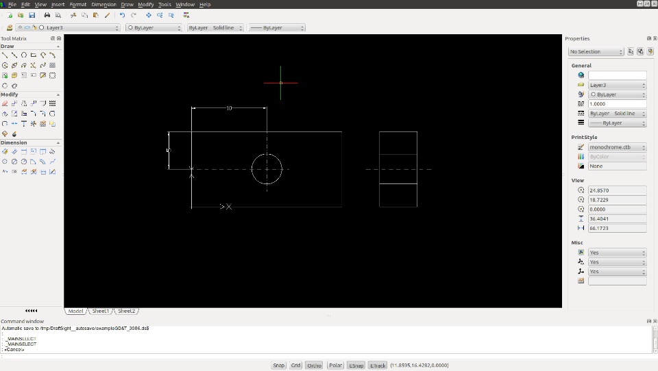

The following example will show you how to add and modify tolerances in a drawing.
The example drawing without Tolerances, Datum Identifiers and Leaders

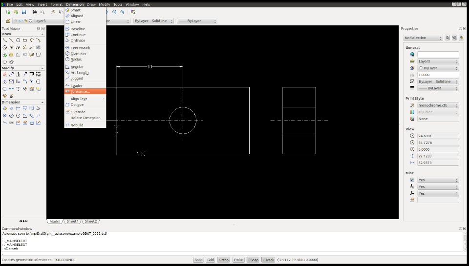

First you have to create the desired tolerances. So use the TOLERANCE command that you can find under the Dimension pull-down menu. In this example you have to use this command 4 times. 3 for the creation of the 3 Datum Identifiers and 1 for the creation of the needed Position Tolerance.
The TOLERANCE command under the Dimension pull-down menu.

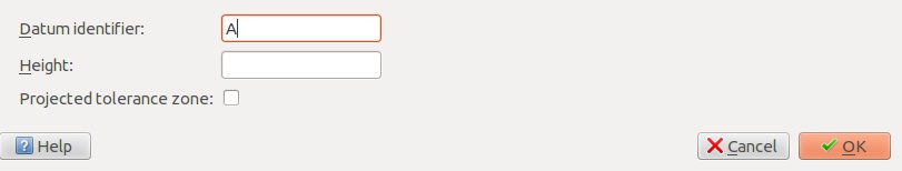

-For the creation of a Datum Identifier use the TOLERANCE command and enter with keyboard a capital letter under the Datum Identifier section of the Tolerance Dialog Box. Then press OK and use your mouse to place the created Datum Identifier in the appropriate location. In this example letters A, B and C will be used as Datum Identifiers.
Creating a Datum Identifier

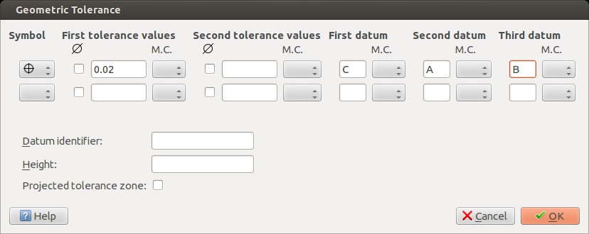

-For the creation of the Position Tolerance use the TOLERANCE command again and specify type, value and datums. In this example you have to use as type the Position Tolerance from the Pull down menu, as value you have to enter with keyboard 0.02, as first datum the capital letter C, as second datum the capital letter A and as third datum the capital letter B. Then press OK and use your mouse to place the created tolerance in the appropriate location.
Creating the Position Tolerance.

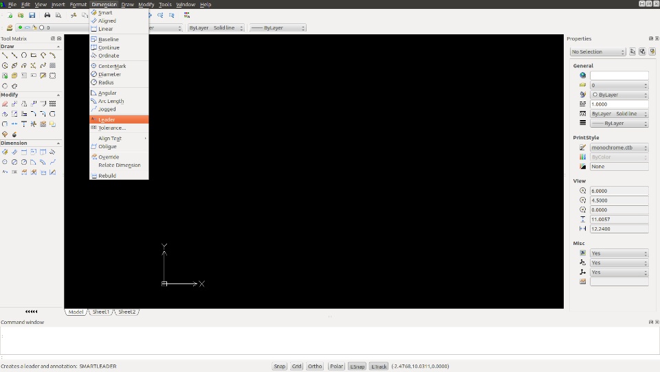

After that, you have to create the necessary Leaders in order to connect the Tolerance and the Datum Identifiers boxes with the appropriate drawing entities. Use the LEADER command under the Dimension pull-down menu to create the necessary leaders. In this example you have to create 4 Leaders, 3 for the Datum Identifiers and 1 for the Position Tolerance.
The LEADER command under the Dimension pull-down menu.

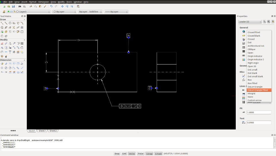

Now you can modify the properties of the created Tolerances, Datum Identifiers and Leaders with the Properties Bar. In this example a necessary modification is the arrow type of the Leaders of Datum Identifiers. Select all the Leaders of the Datum Identifiers and change the Arrow type to "Datum triangle filled". With the Properties Bar you can make a lot of other modifications (Text Height and Style, Precision etc)
Changing the Arrow type with the Properties Bar.

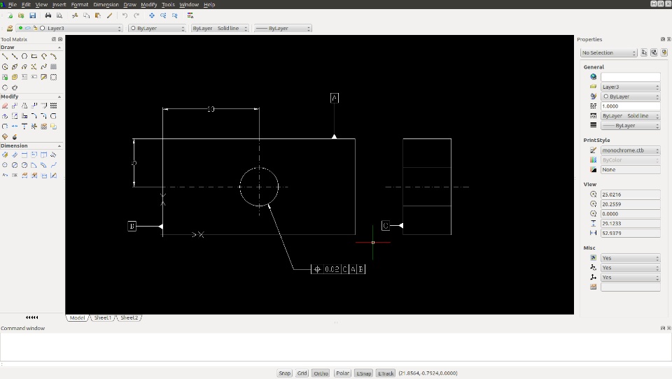

The final result.

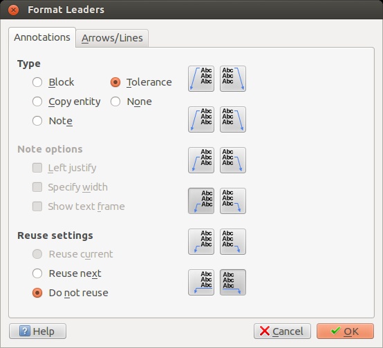

Tip: You can combine the LEADER and TOLERANCE commands by changing the settings of the LEADER command. Just type "s" in the Command line after executing the LEADER command and press enter. In the "Annotations" tab select "Tolerance" as type. With this change after the completion of the LEADER command the TOLERANCE command will be executed automatically.
LEADER command settings.
