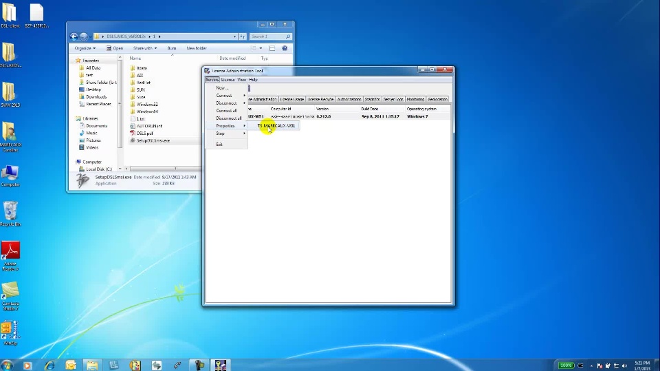

Two short videos to learn how to install the DraftSight Premium Pack
One video shows how to install the license manager, DSLS, on the server and the other one shows how to install DraftSight on the user's machine. The slideshow (PDF) summarizes the process.
This installation of DSLS is for a single server and accepting all the default. Complete information can be found on the DSLS.pdf (Dassault Systemes License Server V6R2012x Installation and Configuration Guide) provided with the software.
