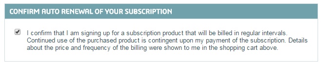

How do I renew my subscription?
When purchasing the product, you can select the option to renew your subscription automatically on each anniversary.
If you do not select this option, you can also use the “Renew DraftSight Professional” option that is available in the DraftSight Help menu:
