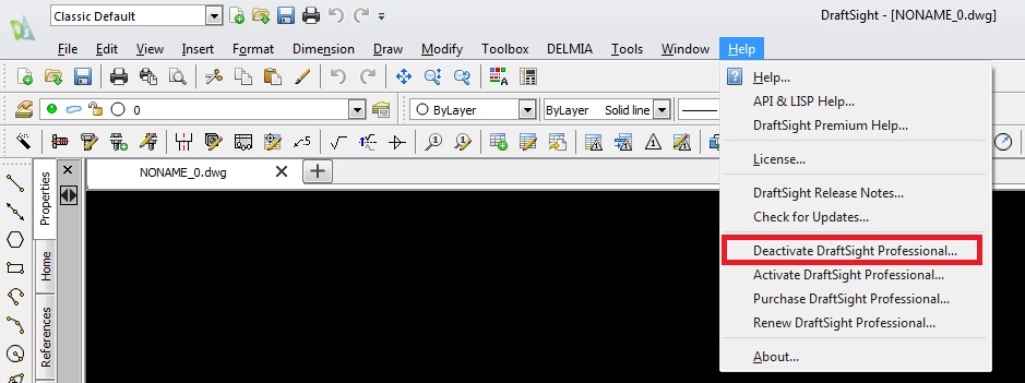

-          Launch DraftSight
-          In the Menu, go to Help, and click the option “Deactivate DraftSight Professional…”

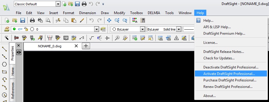

Assuming you have already downloaded and installed DraftSight in the other machine, launch the application:
-          Go to Menu, Help, and click the option Activate DraftSight Professional

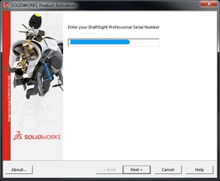

-          In the SOLIDWORKS Activation Wizard, Enter your DraftSight Professional Serial Number
-          The application will connect to the Activation Server, and retrieve the activation data

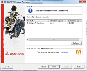

-          Once the process is completed, click Finish, and Restart DraftSight.
