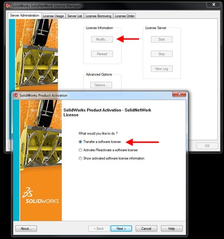

3) Launch SNL. On the “Server Administration” tab, click “Modify”. In the window that opens, select “Transfer a software license”, and click “Next”. When the process is completed, the old Server is disabled, and the new Server can now be activated

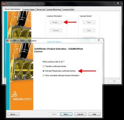

4) Launch SNL, and in the “Server Administrator” Tab, click “Modify”.
In the “SolidWorks Product Activation window, select “Activate/Reactivate a software license”. Once the process is completed, the workstations should now be able to reach the new Server, and draw their licenses from it.
