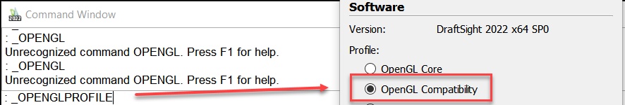

If you encounter the problem, it can be avoided by enabling the OPENGL compatibility option in the Graphics Information settings. The steps do to this are:
1. Launch DraftSight
2. Type command _OPENGLPROFILE then press ENTER
3. In Graphics profile window select option 'OpenGL Compatibility'
4. Restart DraftSight
