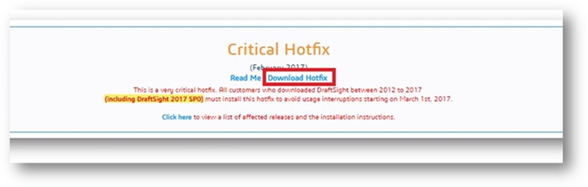

"What is the Hotfix? Do I need to download/install the latest DraftSight version?"
-              Please note that installing the Hotfix does not require the installation/update of the DraftSight version, and the installation of the Hotfix does not impact the Licensing of the product. For additional clarification, the correct download link in the page as shown below:
