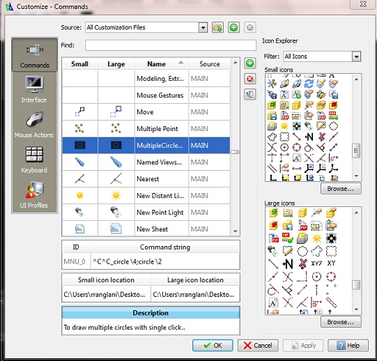

To create a new command:
- Enter Customize command in the Command Window or go to Tools > Customize Interface..
- In the Customize dialog box, in the commands list, click Add Command
- In the Name filed enter your command name
- For Command string, type a command, command sequence, or command option
- Click Show icon explorer to show the icon explorer
- From the Icon Explorer drag a small icon and a large icon to the corresponding Small and Large fields of the new command entry. These icons are used for menus and toolbars. The location and file name of the icons displays in Small icon location and Large icon location.
- For Description, type a description to display in the status line when you move the pointer over the corresponding command in a menu or toolbar.
- Click OK

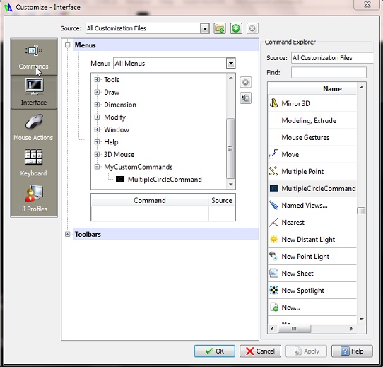

To Crete a toolbar or menu bar entry:
- In the Customize dialog box, expand a menu or toolbar
- Navigate to the location in the menu or toolbar (you can create your menu or toolbar) where you want to place the new item.
- Click Show command explorer to expand the Command Explorer
- In Command Explorer, select a new command entry and drag it to the menu or toolbar
- Click OK

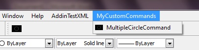

6. And try out your custom command
