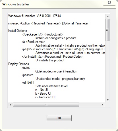

Specify standard optional parameters (Windows Installer Options: msiexec /?)
Example: /qb for non-interactive install using basic UI
E.g. msiexe.exe /i DraftSight.msi /qb
