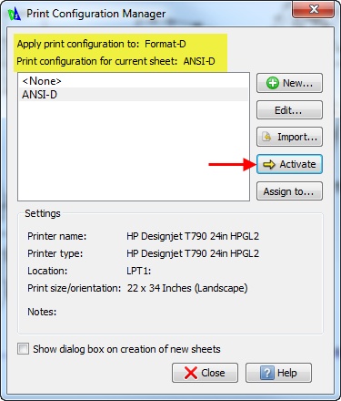

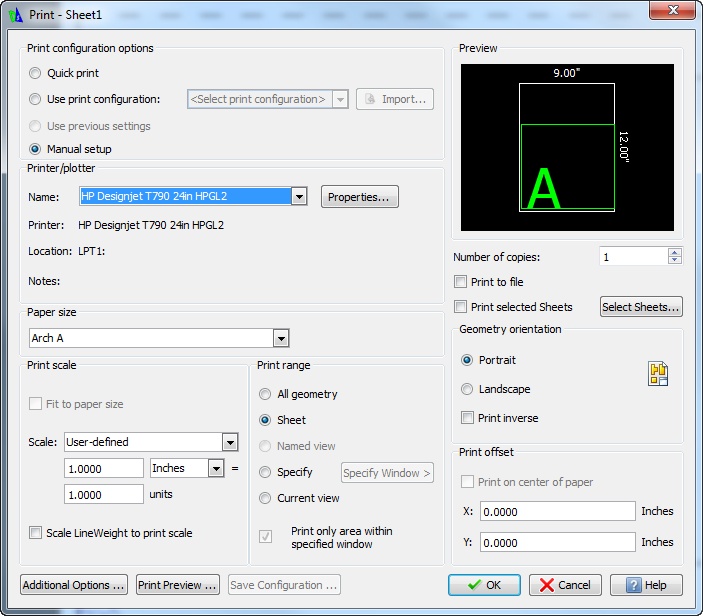

The first step is to create a new print configuration.
- Select File > Print Configuration Manager…
- Click New.
- Click OK in the New Print Configuration dialog box.
- Enter a name for the .CFG file, for example “ANSI-D”, and click OK.

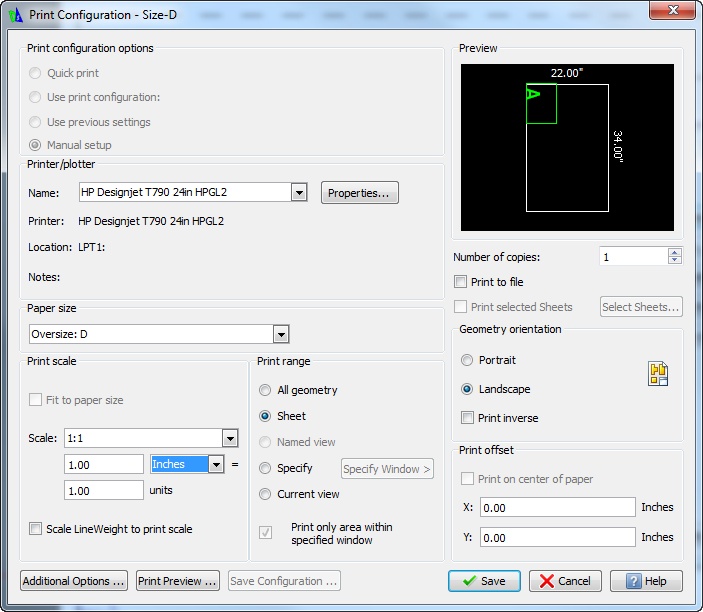

- Set the parameters in the Print Configuration dialog box and save. An example is:
The second step is to assign it to a sheet, here to Sheet1
1. Select the print configuration just created and click on Activate and Close.
The size of the sheet is adjusted based on the ‘Paper size’ set in the Print dialog box.

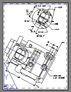

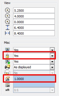

The last step is to adjust the viewport.
- Resize the viewport (by clicking on the border and dragging the corners).
- Activate the viewport (by double-clicking inside the viewport).
- Scale the viewport (from the Properties palette).
- Pan to adjust the layout.
- Lock it (from the Properties palette).

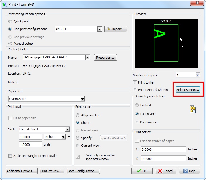

If another drawing has a sheet named ‘Format-D’, the Print configuration ANSI-D will be automatically applied to this sheet.
Batch Printing Sheets

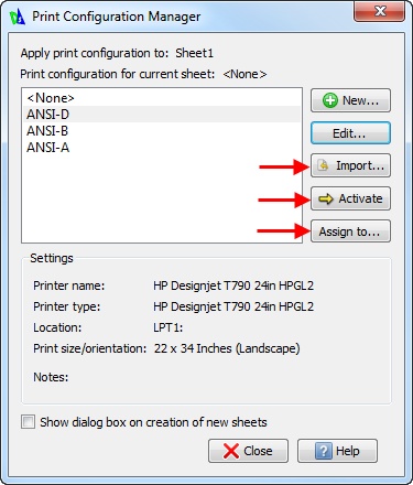

The same procedure can be applied to create additional configurations and use them for other sheets.
Then all the sheets can be sent to their respective printers in one step. By selecting the Select Sheets… button in the Print dialog box, the user can specify which sheets to print accordingly to their respective print configurations.

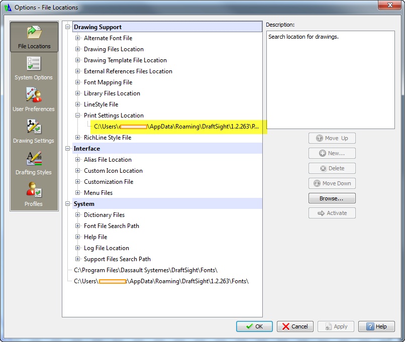

The default location for these files is: C:\\Users\\\\AppData\\Roaming\\DraftSight\\1.2.263\\Print Settings (the name of the 1.2.263 folder varies with the version of DraftSight). This location is set up in the Options dialog box (Tools > Options > File Locations)
The print configuration file can be saved on a network location or emailed to other users. Then after saving it in the local Print Settings folder, the Print configuration Manager allows DraftSight to use it (Import…), apply it to the current sheet (Activate) or to any other sheet(s) (Assign to…).
