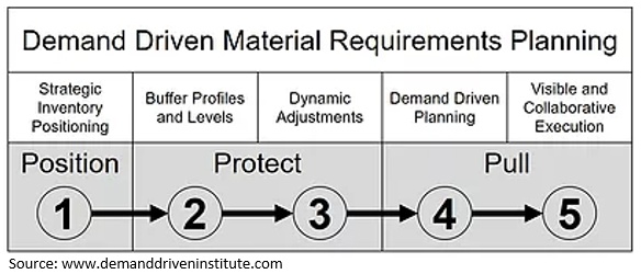

DDMRP in a nutshell:
DDMRP aims at optimizing the inventories levels by determining where the buffers need to be along the BOM levels and what their levels should be to optimize lead times, minimize the overall WIP, absorb the uncertainty of the demand and supplies, generate optimum production / supply / replenishment orders. And all of this in a dynamic way along the horizon to adapt to seasonality or react to demand changes, while providing a colors and priorities based easy to read communication methodology down to the execution to drive the operations.
What it is:
Keeping aside the debates about whether or not DDMRP is lean (nice post at thejitcompany.com here if you feel like deep diving), DDMRP is a significant enhancement of the traditional MRP calculations that enable to manage dynamically the inventory targets and lot sizing policies by periods of time while in traditional MRP these targets are static (or managed at product versions levels) and need to be revisited regularly.
In short, Demand Driven MRP is one MRP calculation methodology and one way to look at the processes that calculate, plan, and drive the execution of the purchasing, production, and distribution orders of a company.
