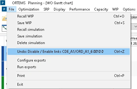

When the UNDO feature is available, you can run it by:
  • clicking the Undo icon in the icon bar
  • selecting File > Undo:
  • pressing Ctrl+Z keys.

From Ortems 2024 Refresh 3, Undo feature supports enabling and disabling links: it is now possible to cancel an enabling link action. It is also possible to cancel a disabling link action.
From Ortems 2024 Refresh 4, Undo feature supports creating links: it is now possible to cancel a creation link action
