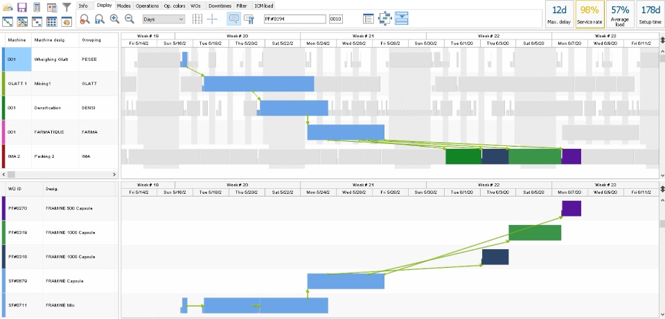

The DELMIA Ortems Synchronized Requirement Planner (SRP) Engine is a feature that generates a production plan and include the inventory / productions allocations within BOM levels.
The Synchronized Pegging mode consists of running the SRP on a pre existing list of production orders, coming from the ERP MRP calculation, to generate the links only.
We can easily identify few values coming from this synchronized pegging capability:
  • Reduce overall manufacturing lead-time: only if you know which semi-finished or sub-assembly will supply which finished-product then you can compress the end to end flow
  • Avoid shortages and production disruptions by always maintaining predecessor - successor relationship
  • Increase traceability and visibility
