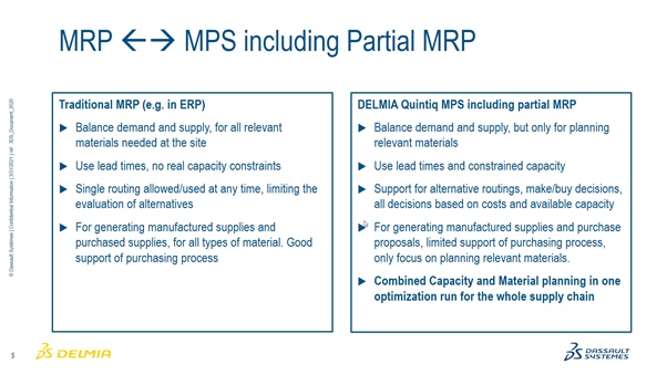

But typically one element is not included in this MRP-run, and that is the capacity usage. ERP systems are not real planning systems, thus there is no proper notion of capacity. This limits the options of the MRP significantly, because things like make-or-buy decisions and alternative product routings only can be evaluated if there is a capacity constraint taken into account. If not, the MRP-run essentially can only choose the cheapest routing.

As mentioned before, MRP in ERP can cater for all material requirements in a company, and it is good at it for many areas. But for the real production related materials it is less suitable, mainly because of the capacity shortcoming. For that reason, our MPS solution is extended with MRP functionality to take care of this part in a more advanced way. We call that replenishment, and it can take care of creating production order proposals and purchase order proposals, that make sure to service all customer/external demands, while making sure to not overload any relevant machines. It will do that also for any dependent demands, and build up a full plan including new production orders and purchase orders.
If there are any alternative sourcing options, such as make-or-buy decisions or subcontracting steps, these can be evaluated by having multiple routings for the same product. Based on routing costs, the system will choose the best way to produce and buy materials, without overloading machines or overasking suppliers.
The DELMIA Quintiq solution supports this by using best-in-class optimization techniques, and the solution takes both replenishment and capacity into consideration in a single step, for the full supply chain that is fed into the system.

To conclude, here is a tabular overview of the MRP capabilities between ERP and MPS, which can be helpful in the understanding of the value of the advanced MRP in DELMIA Quintiq MPS solutions.
