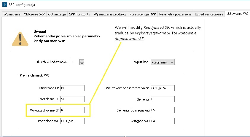

We want to change some words/spellings in our planning in order to respect the language user’s specificity.

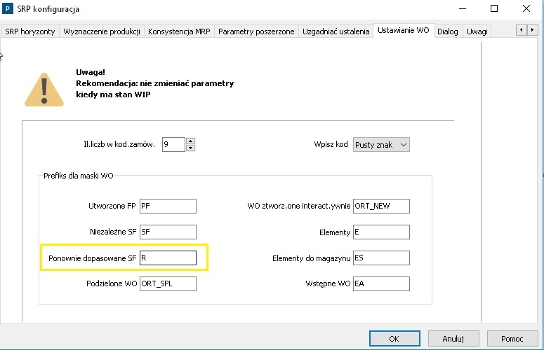

For our demonstration, we’ll imagine we want to modify the polish translation of words to match the customer glossary.
We will modify Readjusted SF, which is actually traduce by Wykorzystywane SF for Ponownie dopasowane SF.
We will also create a new available language from the planning to show it is possible easily with DELMIA Ortems.

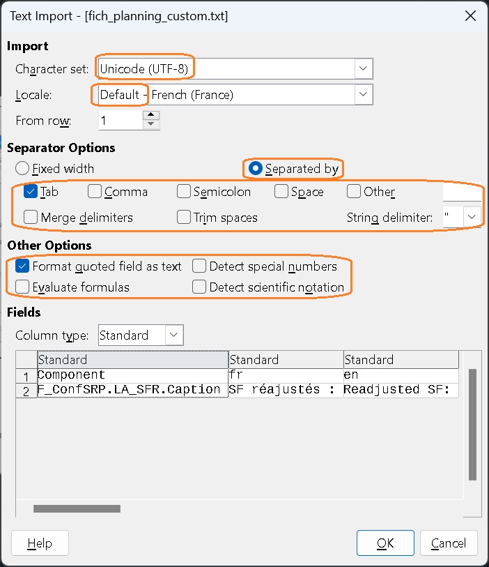

  • OpenOffice/LibreOffice must be installed and must have this settings:

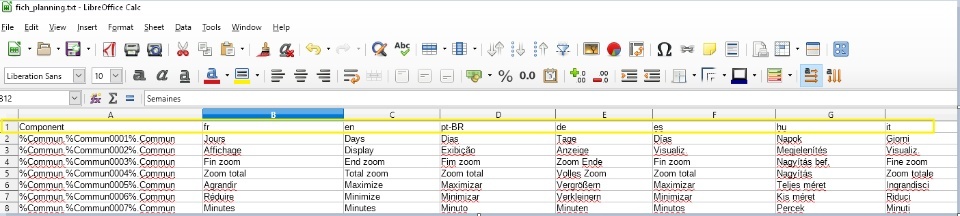

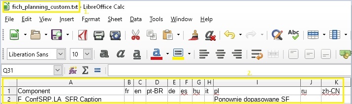

2. Open fich_planning.txt and look for the value Readjusted SF on the en column (do not be surprise if you find multiple match, this word could be use many time on the Planning – it depends on you to choose where you want to change it) then copy the Component name.
3. Copy files fich_xxx_custom.txt and rename it by fich_planning_custom.txt and open it
4. You’ll find the same structure, add the right translation on the PL columns:
5. Open your planning, and look for the new value

  2. Open fich_planning_custom.txt with LibreOffice and add a new column for your new language

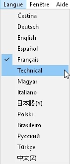

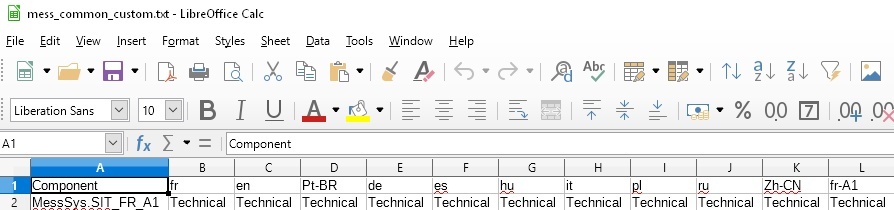

Then, for the new language(s) to be available in the “Language” menu:
  1. Create a file mess_common_custom.txt (empty)
  2. Open mess_common_custom.txt create as many rows as you have new specific languages (with the new language columns).
  3. For each language, note the wording you want to appear in the Language menu
On Planning:

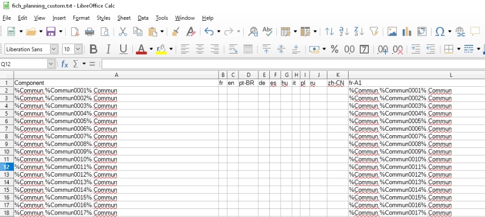

Where can you find the value of the component you are looking for?
In order to find the value of the component you are looking and in order to exercise yourself with the steps above:
  1. Open your fich_planning.txt
  2. Copy all the value listed In the field Component (A)
  3. Open you fich_planning_custom.txt previously created and pass all the value previously copied

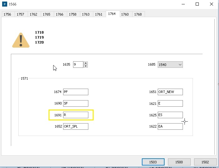

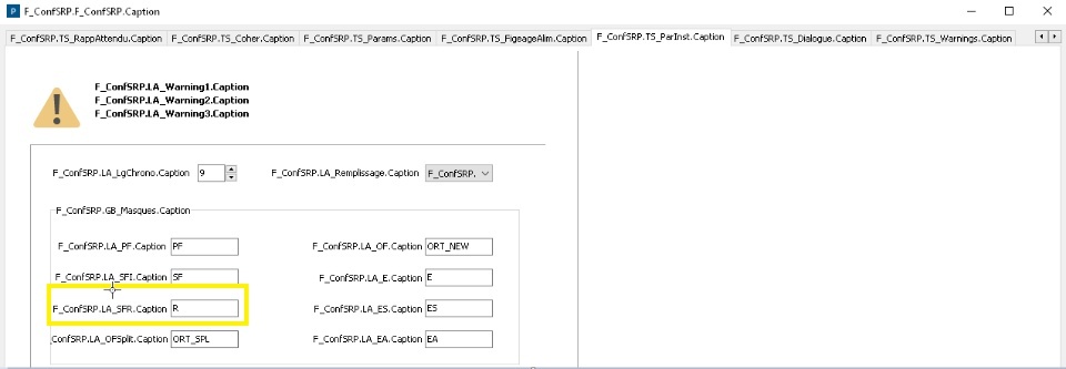

  4. Pass it also under the value of your language - see the pitcher bellow(fr-A1 was mine)
5. Open your planning and switch the language to the created one, the Planning components will change to the component technical name – see the pitcher bellow
Warning:
Sometimes, the component technical name is too long to be fully displayed which can be problematic when you want to change this value. In this case, we recommend using the line number instead of the technical name (or 1 letter followed by the line number in the file if you manage several file at the same time).
