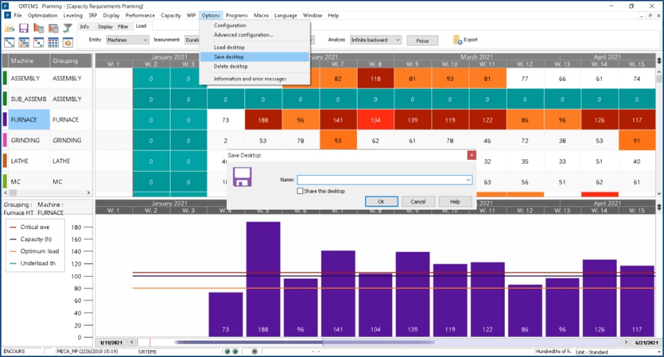

What a "Desktop" is:
A DELMIA Ortems Desktop stores a specific Planning application display configuration including the type of charts open in the application, the time unit, the main display options, the filters and sort orders defined etc.
A user can configure and save several Desktops, for different use cases and can also share them with other users.
Finally, each Desktop can be associated to a keyboard shortcut in order to enable users to easily switch from one view to another.
How to configure "Desktops":

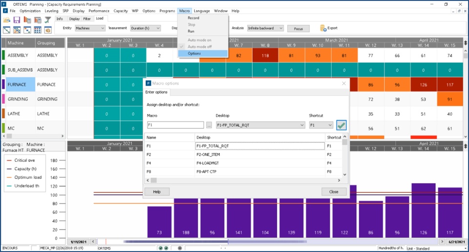

​​​​​​​​​​​​​​Once you have configured your view, you can save it as a Desktop via Options -> Save desktop and by capturing the name of your view.
After saving your Desktops, you can now associate them to keyboard function keys via Macro -> Options, by browsing a macro file and linking it to the Desktop and keyboard shortcut.
Accessing these "macro files" depends on your DELMIA Ortems installation. Don't hesitate to contact DELMIA.Ortems.Support@3ds.com to get some help.
You are now ready to switch from one view/analysis to another and thus to spend your time making smart planning decisions rather than (re)configuring views.
