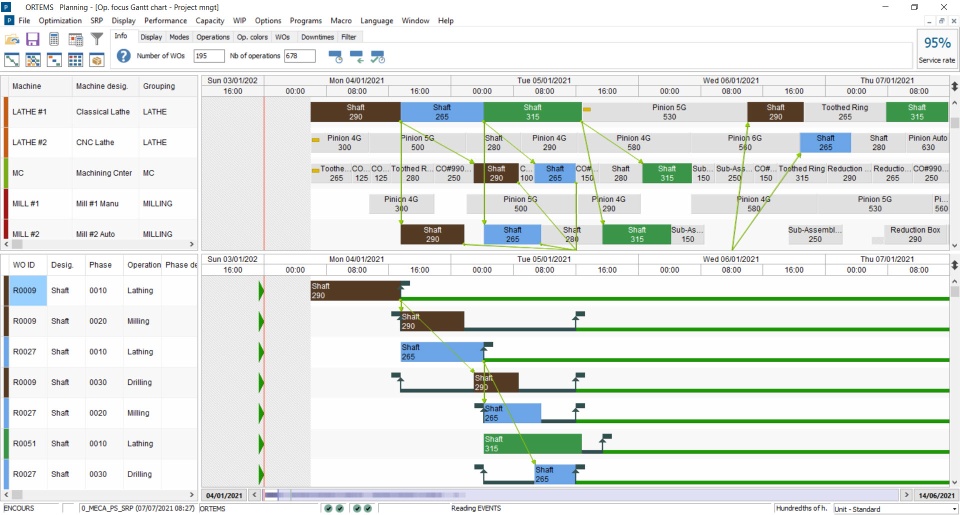

In DELMIA Ortems, you have the opportunity to highlight operation, WO, series, critical path or static links between several operations / WO for example. But what if you want to highlight several WO?

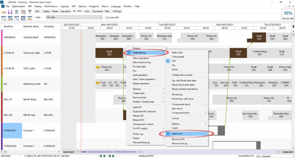

In the "Highlighting" menu, you can select the option "Add to list". This way, you'll be able to select several WO / operations / series...
This could be interesting if you want to have a deeper analysis on an Operation focus Gantt Chart for example on these selected WO for example. Then you can quickly and easily press Escape to reset your selection and try a new analysis.
A single click which can save you a few minutes!
