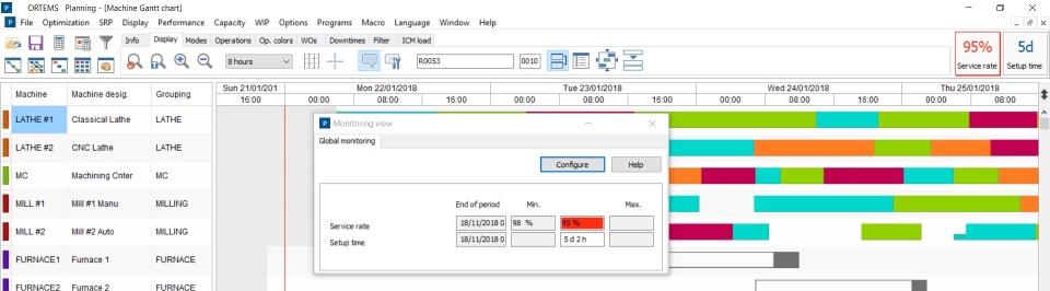

Some of you may know it, you can display KPIs on top on your DELMIA Ortems screen. As they are dynamically calculated, it is a good way to visualize directly the impact of your actions when you are doing a simulation (machine maintenance, new Work Order, missing people...)

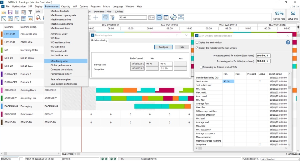

How to display these indicators?
Go to "Performance" menu > “Monitoring view”.
On the “Monitoring view” window, you can see the active KPI (which are displayed). Click on “Configure” to modify them.
On the “Alert window configuration tool” window, click in the “Active” cell to display or hide a KPI. You can also configure the thresholds for each one.
Be careful, the setup time is only displayed in days.
You can display up to 12 indicators simultaneously.
