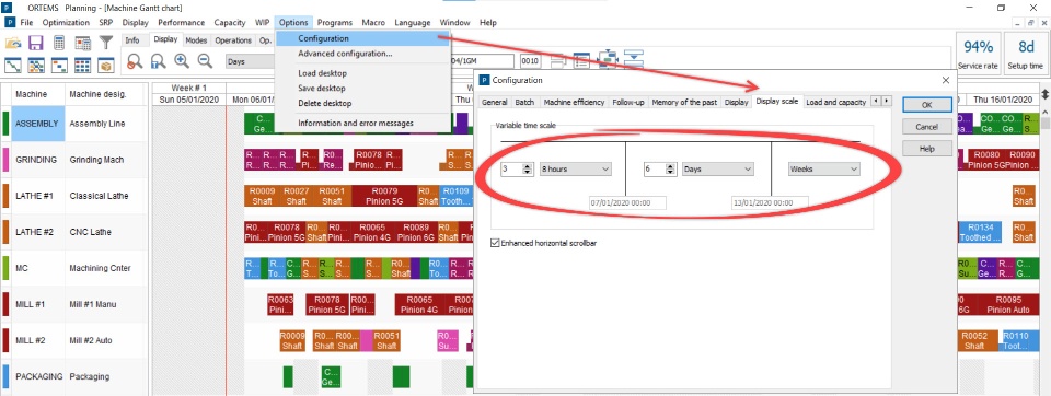

How to configure it?
In the planning module, go to Options > Configuration and select the "Display scale" tab. Here, you can choose your bucket and how many of each you want to display.
How to use it?

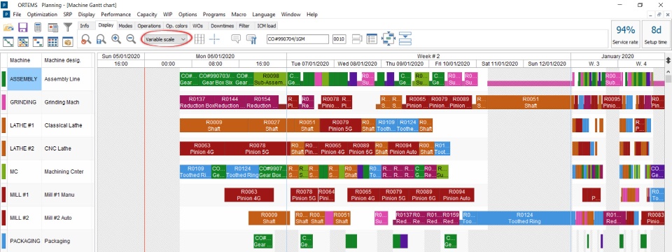

In the planning module and the Display sub-tab, select "variable scale" in the scrolling menu. That's all, enjoy your new screen!
