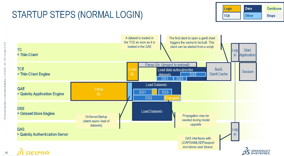

Startup sequence
To better understand the fail over scenario steps, it is important to first understand the startup sequence of a DELMIA Quintiq solution. To run any DELMIA Quintiq solution the following  components are required:
  • QDBI (aka QDBODB) - the database integrator that manages the Dataset Store (DSS)
  • QAE - the application engine that manages data and business logic
  • QTCE - the visualization engine that manages user sessions
  • TC/WC - user interface that displays data and is used to trigger transactions
These components need to be started in sequence as they depend on each other: the QAE loads datasets via the QDBI, the QAE pushes data to the QTCE and QTCE pushes data to the TC/WC. This sounds simple but there is a lot more to it as can be seen in diagram below that describes the startup sequence:
Two steps that are on the critical path and can take relatively long are:
  1. Parse BL (Business Logic): loading and parsing of the object and UI definitions
  2. Load datasets: loading of relevant datasets from the DSS
The duration of the first step depends on the size of the model definitions. For example each quill library will be loaded sequentially and this can take up to several minutes. The duration of the second step depends on the number and size of the datasets. Datasets can be loaded with a very high speed (Gigabits per seconds) but this process can still takes minutes when loading large datasets. If propagation is needed, the loading time will be even longer.

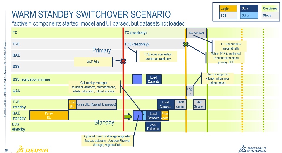

Warm standby failover scenario
The diagram below explains how the warm standby switch over works.
In case of a scenario where the primary QAE fails, the QTCE keeps running in read-only mode. This means that the users are still connected and can view data but cannot start new transactions. Then the secondary QAE receives a notification to unlock and load the datasets. Once the datasets are loaded in the QAE, the secondary QTCE will automatically receive the data due to the auto-subscribe feature. The primary QTCE is then stopped to trigger the reconnect functionality in the TC/WC. As the primary QTCE is not available anymore, it will then connect to the secondary QTCE. As soon as the session is created, the user can resume normal operations.
What is worth noting is that during the switch from primary to secondary environment, the TC/WC keeps running and no restart is needed. Also when connecting to the secondary TC/WC, the user does not need to log in again. So the worst case is that the user cannot make any changes for a limited time.
