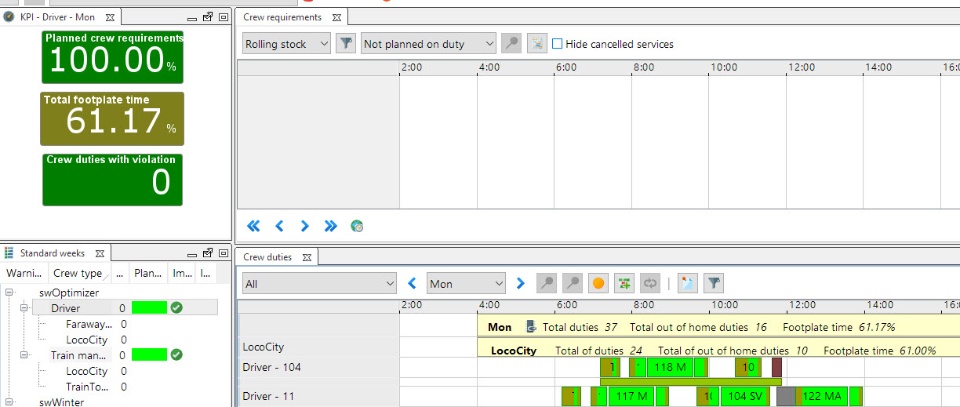

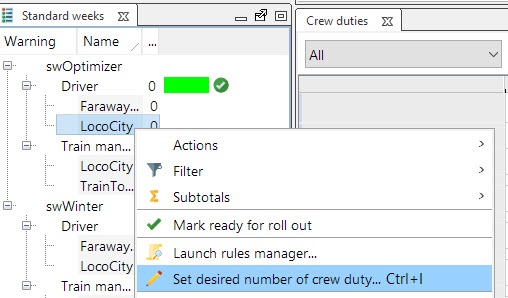

In above screenshot a first result of an optimizer run is shown where 24 crew duties have been generated for depot LocoCity. However, in total there are only 37 crew duties which would put relatively a too high load on this depot, therefore the planner decides to set a desired number of 20 crew duties for LocoCity. He does that by opening the context menu on the standard weeks and depots list, while selecting depot LocoCity.

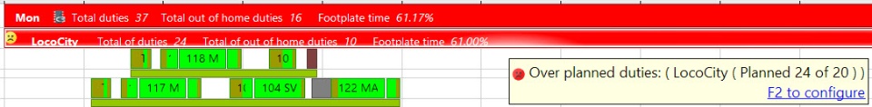

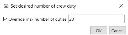

After overriding the maximum number of crew duties for LocoCity to 20 a constraint violation appears, indicating too many (24) crew duties are planned for LocoCity.

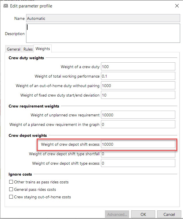

He starts the optimizer again, checking also the optimizer weights to ensure a heavy weight is set for avoiding too many crew duties being generated for a crew depot.

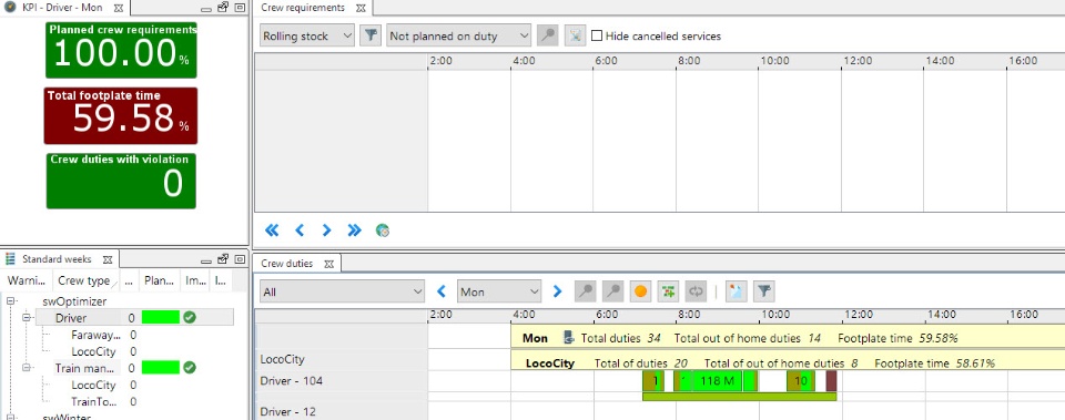

Continuing the optimizer run a new solution is proposed by the optimizer where now only 20 crew duties are selected for the crew depot at LocoCity.
