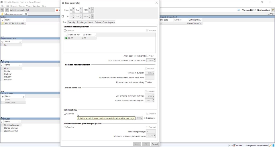

When creating a crew plan it’s important that as a planner you can check whether it adheres to the labor rules. Sometimes different values for the same labor rule apply to crew based at the same location, e.g. due to different labor union agreements or specific agreements with certain employees.
DQ Fleet & Crew Planner offers the possibility to apply overruled values for groups of employees planned within the same location to give full support on checking labor rules for all the employees that are planned in the crew plan. Below video shows you how it works.

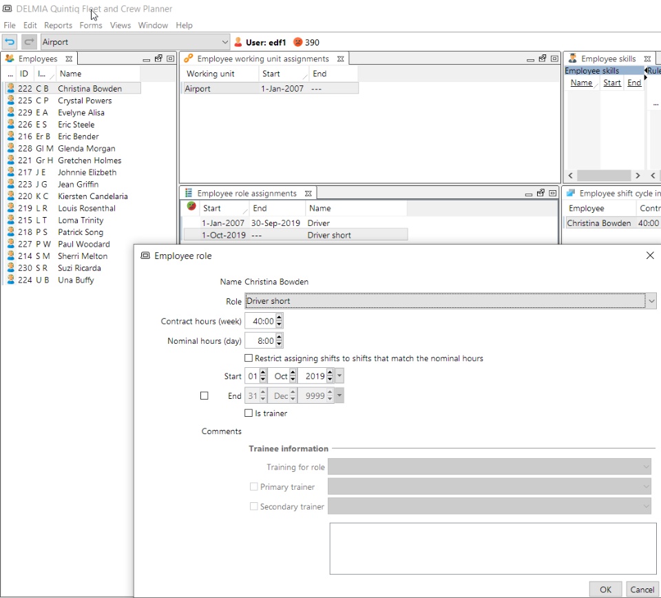

  7. In the planning client in view 14 Manage employees you can assign an employee to the new working unit role from any desired date as shown in the screenshot below.
