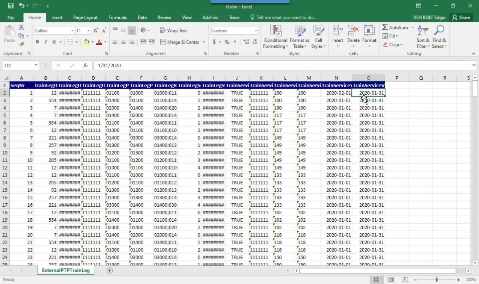

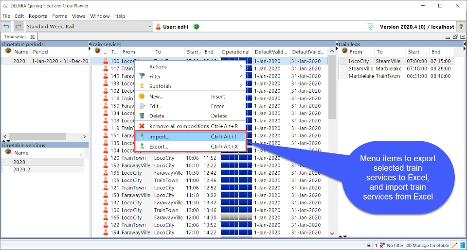

DQ Fleet & Crew Planner has an easy way to transfer train services between different datasets or servers through Excel by exporting the selected train services to an Excel-readable file, which can also be imported again into a new timetable version, either in the same dataset or in a different dataset. This could even be on a different environment as long as the locations defined and used in the definitions of the train services are still identical.
Below video shows you how it works.
