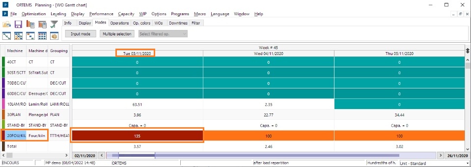

Here is an illustration of another usage of Mass modification: fast checking if among the operations loading an overloaded resource (primary or secondary) during a specific time bucket, some of them have specific leveling properties, themselves or their WOs.

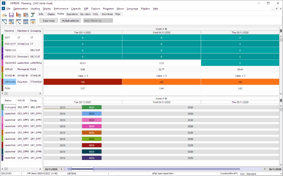

After a load-leveling optimization, an overload is detected on a resource on Tuesday, November 3rd (leveling time bucket is set to “1 day”):
After checking that this resource belongs to a grouping on which leveling box is checked, that this day belongs to the leveling horizon and that the other leveling settings are OK, I need to analyze the operations planned on this resource on that day.

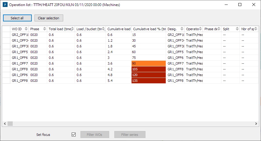

1st step: click on the cell where the load/capacity rate is 135 %, to list the operations:
Highlight the operations contributing to the load
Click on “Select all” and “Filter WOs”.

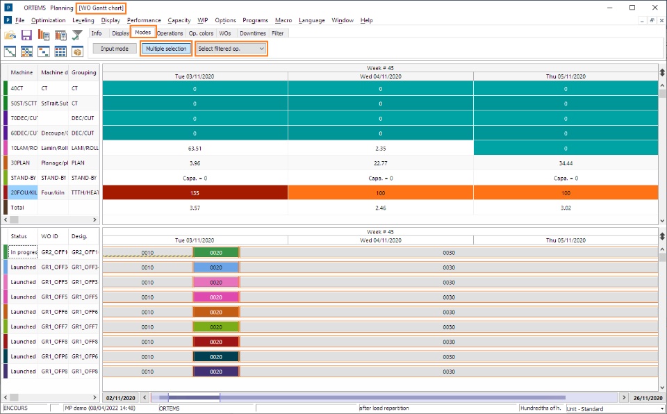

Split the screen to keep Capacity Requirement Planning on top and WO Gantt chart below:
On this example, only 9 operations are concerned and need to be analyzed. But on a production environment, we are more likely to have many operations to check.
Now let’s enter is Mass modification mode:
For that, after activating WO Gantt chart, click on “Mode” tab, click on “Multiple selection” to highlight the button in blue, and select “Select filtered op.” in the combo box:
All the operations of the selected WOs have an orange rectangle to highlight they are selected.

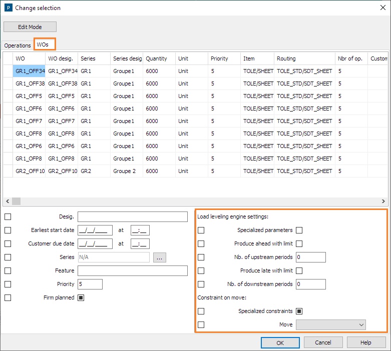

Now, over the WO Gantt chart, Right click > Modify.
From “WOs” tab, in the bottom right corner, we can observe 2 sets of indication:
  1.  “Load leveling engine settings:” no box is checked, nothing interesting for our analysis.

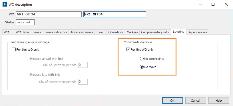

  2. Constraint on move: “Specialized constraints” has a black square to inform that among the selected WOs at least one has a specific constraint => this is the next action to perform: identifying those WOs. It is not possible to filter WOs on this specific constraint (at least not possible when I was writing this post) except by checking one after one (or querying the environment DB on E_OF table, records where LBE_SPECIF=1 and LBE_STATUT=1). Visually, it is possible to detect the operations if “WO start” information is displayed (from “WOs” tab). In that situation, operations that can’t move have a velvet triangle (but hidden if a non-automatic fix start date was set on the operation):
Let’s open this WO: it cannot move, meaning that none of its operations can be moved by the load leveling optimization engine.

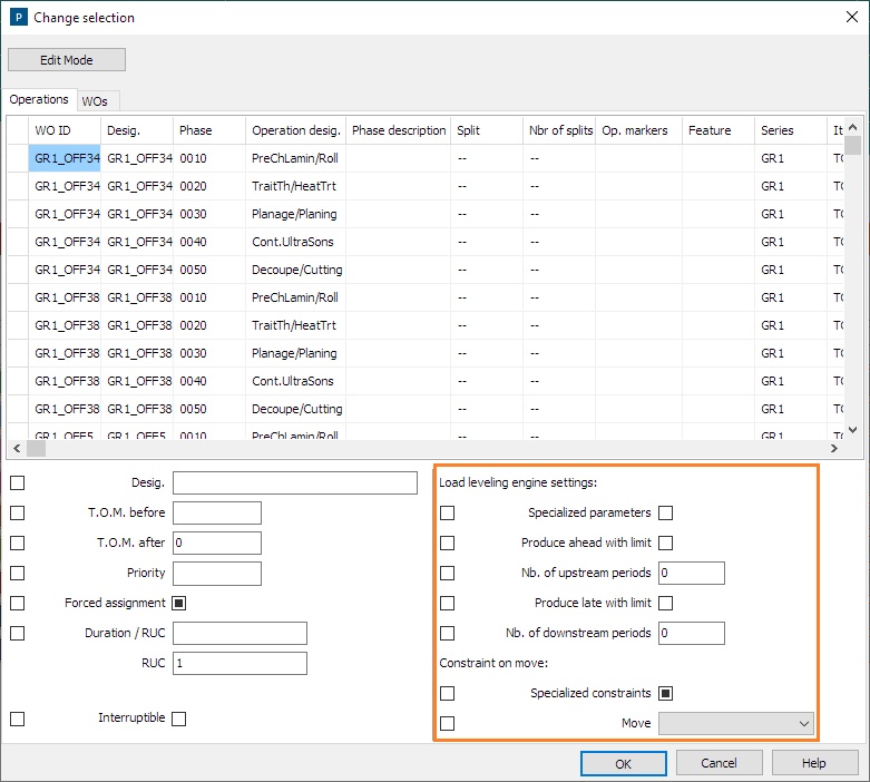

From “Operations” tab, in the bottom right corner, we can observe 2 sets of indication:

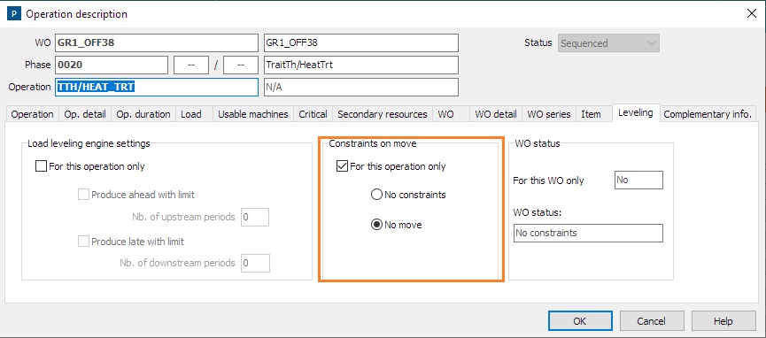

  2. Constraint on move: “Specialized constraints” has a black square to inform that among the selected Operations at least one has a specific constraint => this is the next action to perform: identifying those operations. It is not possible to filter operations on this specific constraint (at least not possible when I was writing this post) except by checking one after one (or querying the environment DB on B_BT table, records where LBE_SPECIF=1 and LBE_STATUT=1). Visually, it is possible to detect the operations if “WO start” information is displayed (from “WOs” tab). In that situation, operations that can’t move have a velvet triangle (but hidden if a non-automatic fix start date was set on the operation):
Let’s open this operation: it cannot move, meaning that it cannot be moved by the load leveling optimization engine:
