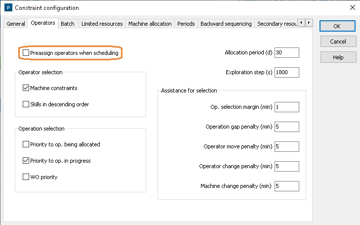

About that feature
The feature is located in Planning program > Optimization > Constraint configuration.
It is available since DELMIA Ortems release 2021.

What will change if "Preassign operators when scheduling" is enabled?
With « Preassign operators when scheduling » setting activated, the optimization process is slighty different:
During the scheduling optimization, if an operation requires a not yet available operator, the operation is managed as if it has a Fixed Start Date = Operator availability. That operation, not planed yet, can be scheduled immediately because it belongs to the group of operations that can be scheduled immediately. BUT the scheduling criteria may prioritize other operations. If these criteria are for example prioritizing minimum operation start date, it is likely that the gap until the operator availability can be filled with other operations not having such a constraint.
This reduces the holes in the plan in case of operators not available. However the ability to fill the holes depends on the scheduling criteria used.
Using a criterion that targets to prioritize the minimum operation date is more efficient to fill the gaps.
