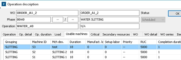

Example to illustrate this feature: How to add a Machine into the usable machines without exiting the planning?
Add machine on Installed machine base
Open your data module, then navigate on Installed machine base. You’ll need to add a new machine on the machines list by using the insert button.
After filling the fields, you’ll see your new machine on the Machines list
Reload Work Order
In order to have the most up-to-date information available without unlaunching and relaunching those WOs:
On a Gantt chart, you need to choose RELOAD WO from the right-click menu, and then click the on the WO you want to reload (you can also use the multiple selection feature, but you cannot select a WO from a campaign series).
A message reminds you that all the changes that were made to operations of the selected WO(s) in WIP will be lost, and asks you to confirm that you want to proceed.
When you do, the software checks whether it can actually reload the necessary data, and warns you if it can't - Note that you can also use the RELOAD WO command in collaborative mode.
Usable machines
On a Gantt chart, you need to choose Display from the right-click menu, and then click the WO and navigate to Usable machines.
