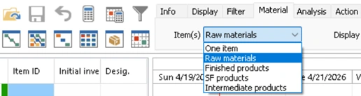

Previously, it was only possible to display:
- Either a single information row for multiple items of a selected type (Raw materials, Finished products, SF products, Intermediate products).
- Or multiple information rows for a single item.
However, it was not possible to display a list of all the items.

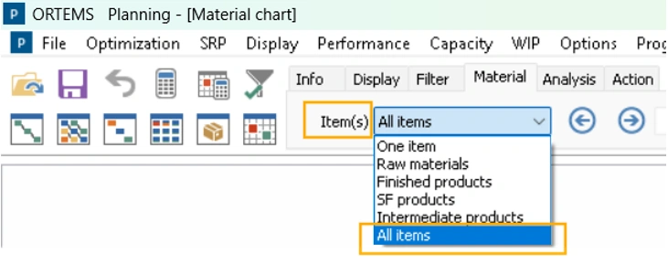

From the Planning application, in the Material chart, you can choose to display all items:

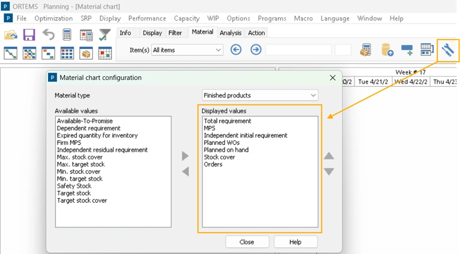

The planning view displays each item’s information in separate rows according to the values selected in the Material chart configuration:
