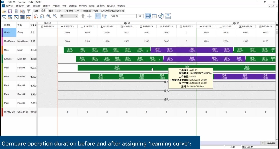

In DELMIA Ortems, learning curves model how production efficiency improves as an operation progresses. For example, there may be a learning curve for an assembly routing. Whenever the assembly plan changes, there is a new learning curve to consider. When you apply a learning curve to an operation, in the plan, the time required to perform the operation is weighted by the efficiency of the machine.
Please refer to the video below for reference.
