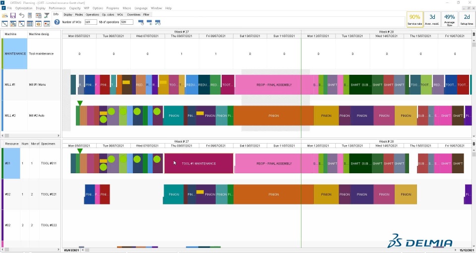

Use case
Customer using limited resources features may want to change the availability of tools over the time, mostly for tool maintenance. In the standard definition of limited resources you cannot vary the capacity over time. This advanced modeling proposal intends to cover this use case.
This video illustrates the proposed modelling

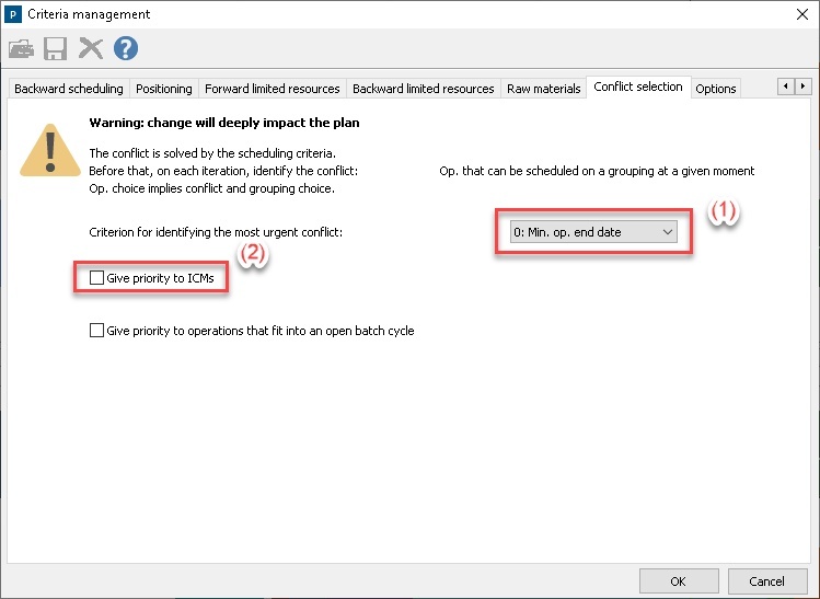

  • Criteria management parameterization: (not a mandatory step, other setup can work)
    • (2) Deactivation of « priority to ICM »
    • Very technical comment: (1) the first short operation allows the maintenance order to elect the « maintenance » grouping as « the most urgent conflict »

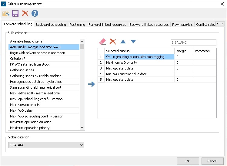

  • Scheduling criteria parameterization: Hereunder the associated criteria. Please note other set of criteria can also work:
  • Creation of a maintenance order
    • It can be created locally in Ortems (planning or WIP module) or automatically when receiving maintenance orders from external systems. I use a high WO priority to ensure it's quickly positioned by the scheduling engine.
