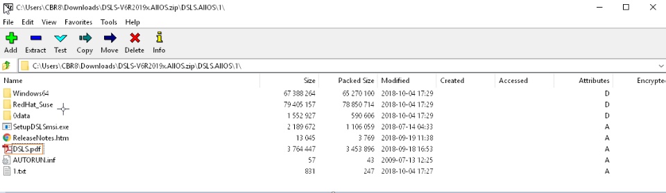

2. Install your DSLS Server
All instructions are located on the zip file you just download.
  • Extract it to hard-drive
  • Open the DSLS.pdf file and follow the steps
  • Check that the client firewall, server firewall, network equipment and security software are properly configured. The TCP (HTTPS) protocol must be allowed from client to server typically on port 4085, or another port number if your server is configured to listen to a non-default port number.

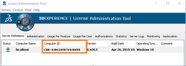

3. Computer ID
There are 2 ways to identify the Computer ID:
  • open the software “License Administration Tool” (By default: C:\\Program Files\\Dassault Systemes\\DS License Server)
Your “Computer ID” is located on the “Server Definitions” tab

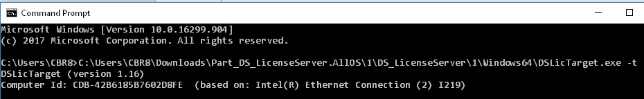

Or
  • launch the software DSLicTarget.exe using the command prompt and add “–t” at the end.
This software is located on the zip file at the following path (xxx\\Part_DS_LicenseServer.AllOS\\1\\DS_LicenseServer\\1\\Windows64)
Repeat this action for each of your 3 virtualised servers

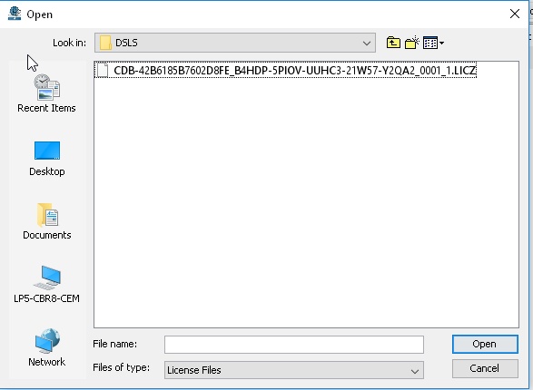

5. Installation of the license key file (action to be performed on each of your 3 virtualized servers)
Concerning the installation, you need to:
  • Open the software “License Administration Tool” (License Server Administration), ensure that the status of your server is “Connected” otherwise Right Click and Connect it.
  • Click on the License menu and Enroll
  • Select the file you received from the KMC team (LICZ extension)
##NOTE## be careful where have saved the file, the screen shot below shows a file path that is normally rights restricted

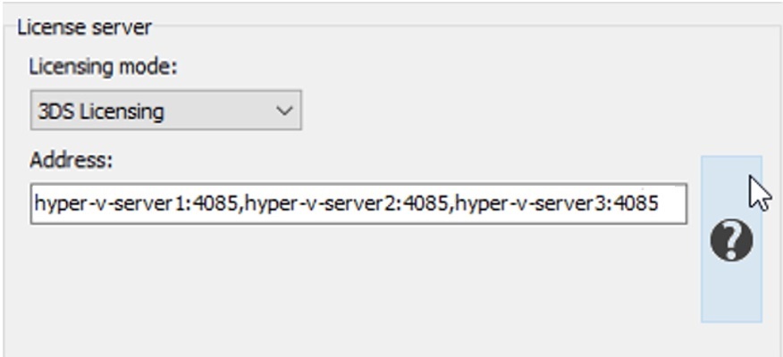

6. Configuration of DELMIA Ortems to switch on DSLS license keys
  • Open the DELMIA Ortems “Environment management” module
  • Navigate to Administration > Advanced settings
  • Change the Licensing mode to 3DS licensing
When using 3DS Licensing with a license server cluster in failover mode, enter the names of the 3 servers and port numbers, separated by semicolons.
Click on the test license server button to check your installation.
