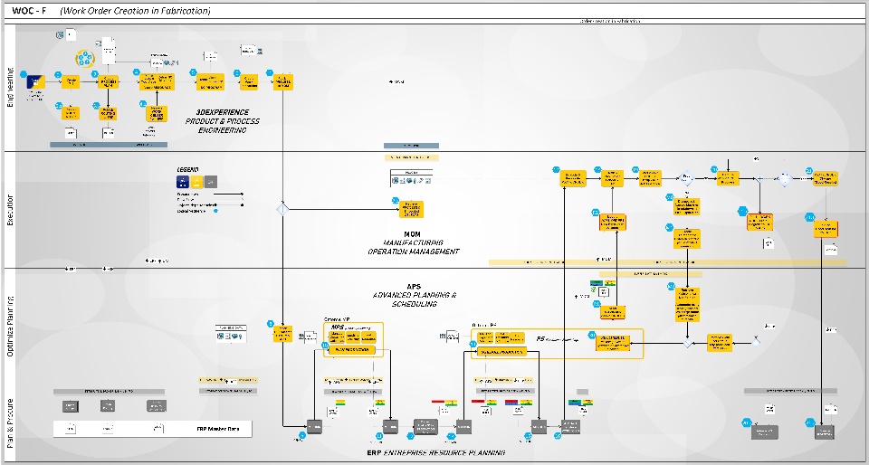

Work Order Creation in Fabrication (WOC-F) differs from 2 previous Scenario "Work Order Creation" (WOC) & "Closed Loop Issue Resolution" (CLIR). Because here we tackles Quantity
WOC-F scenario focuses on machining (subtractive mfg.), inside a machine shop.
Please find below Process flow Diagram:  (download pdf)
Key Topics and Concepts (beyond WOC & CLIR)
  • Multiple MID / Workplan / Process Plan structures for machining
  • Modeling an OR relationship between capable resources for a machining operation
  • Moving from virtual (DM Capable Resource) to real (Apriso Equipment) using Ortems Production Scheduler to select the equipment to be used
  • MRP Simulation - Generating planned orders (qty. > 1) from demand for products against a multi-level BOM
  • Focus on the difference between Ortems Manufacturing Planner (Capacity Planning) and Ortems Production Scheduler (PS) (Sequencing), and how they can be used together
  • Work order reconciliation in Apriso that includes the specific equipment selected for an operation (from Ortems PS)
  • Apriso Production Monitoring Cockpit, adjusted to display operations allocated to equipment
  • Equipment focused operations on the shop floor that incorporate Apriso’s Distributed Numerical Control (DNC) application
  • AEClab’s Production Console (PCO) – A rich Apriso implementation for fabrication operators
  • Direct connection between Apriso and Ortems PS to for equipment state information and emergency re-schedule updates
