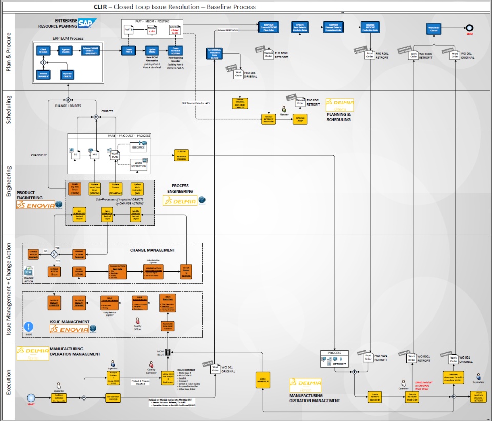

Closed Loop Issue Resolution (CLIR) is an extension of Work Order Creation (WOC).
It adds to WOC below process Steps:
- Non Conformance & Issue Management into the MOM (DELMIA Apriso)
- Issue Management from into the 3DEXPERIENCE Platform
- Change action ... including objects impacted by Change (Part, MBOM, Routing)
- Change Number & effectivity
- Product & Process engineering Change propagation to ERP
- Planning Adjustment (DELMIA Ortems)
- Production Back on Track & genealogy (DELMIA Apriso)
Please find below Process & data flow diagrams explains the different steps of the CLIR scenario:
- Data elements involved
- DELMIA Apps interactions
