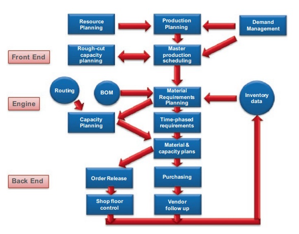

MRP II basically is MRP I plus a number of extensions, to compensate for the fact that MRP does not take capacity constraints into account very well. Below is a picture of the MRP II framework, with MRP (I) in the middle. This framework still is the basis of the planning functionality of ERP systems today.
MRP II contains tools such as:
  • Rough-cut capacity planning (RCCP), which provides a high level capacity check on the Master Production Schedule level.
  • Capacity resource planning (CRP), which introduces a basic way to visualize potential capacity problems resulting from the MRP-I run.
Though RCCP and CRP were introduced to deal with the shortcomings of MRP, they did not much more than visualize potential capacity issues. Solving such issues was still the task of the human planner. For example, when CRP would show an overload on a specific workcenter, the planner would have to manually replan order by order to solve the overloads. Initially, no Gantt charts nor interactive tools were offered.
