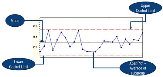

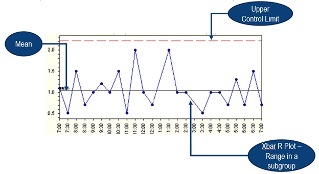

1. XBAR & Range
It helps in controlling the level of variability of a Process. This control chart is also very useful in monitoring the effects of Process improvement theories.
  • X-Bar chart shows how the mean or average changes over time for a subgroup.
  • R chart shows how the range of subgroups changes over time.

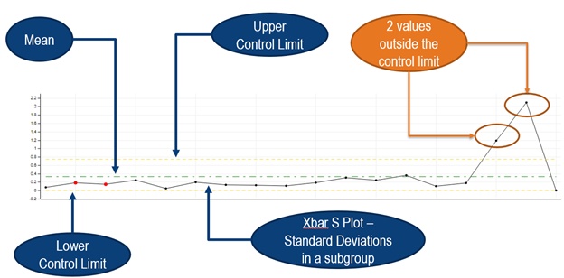

2. XBAR & Sigma
X-Bar charts and S charts show if the system is stable and predictable. These charts use a subgroup standard deviation.

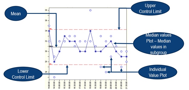

3. Median Charts
Chart shows the spread of the Process output and gives a picture of the Process variation. Shows users that individual data points can fall outside the control limits, while the central location is within the limits.

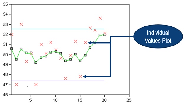

4. Individual Measurement
Shows individual readings instead of subgroup averages .Used for short production runs, small amounts of data.

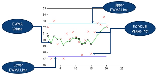

5. EWMA Chars (Exponentially Weighted Moving Average)
For variable data that is both continuous and quantitative in measurement such as a measured dimension or time. A weighting factor is chosen by the user to determine how older data points affect the mean value compared to more recent ones. Because a EWMA chart uses information from all samples, it detects much smaller Process shifts than a normal control chart would.

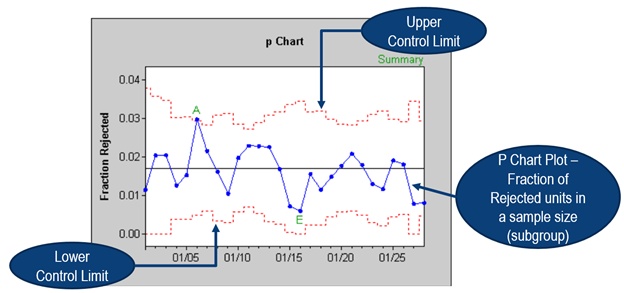

1. P Chart
Displays the fraction of non-conforming (defective) samples, which is the ratio of non-conforming parts/samples to the total quantity of parts inspected.

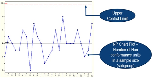

2. NP Chart
Monitors the number of non-conformances (np). Multiplies the sample size (n) by proportion (p) to show the actual count of nonconforming items

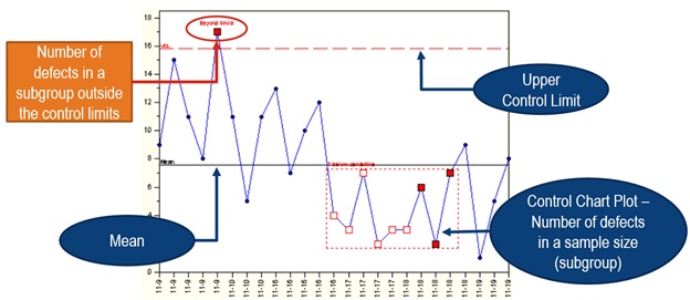

3. C Chart
Displays how the number of defects, or nonconformities, for a Process or system changes over time. Helps determine if a process is stable and in-control or unstable and out of control.

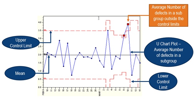

4. U Chart
Displays the number of non-conformities per unit.

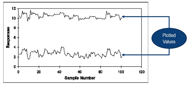

5. Run Chart
Displays plots of Process Characteristics against time or in chronological sequence. Helps find trends or patterns in a process. It can be a valuable tool at beginning of a project as it reveals information about a process before collecting enough data to create reliable control limits.
