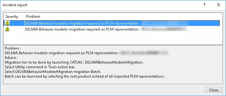

Some of you may get a message when opening data in DELMIA Behavior Modeling.

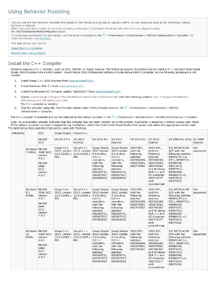

You will only need to process your data if you face attached  pop-up (pop-up.png). In such case, we recommend you  :

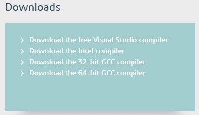

  • As a prerequisite, to have a compatible C ++ compiler with Dymola is installed on the machine, please find here the supported compiler versions.
    • Download the Compiler at the bottom of the page
  • To process your data through CATUtil tool by following the steps detailed in the complete procedure below (section “Migrate Data Using a Batch”)
​​​​​​​Complete Procedure
