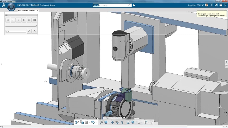

What's New in R2015x - 4 : Support Static/Rotary representation in simulation
During turning or mill-turn simulation, it is now possible to have a different representation for resources (chuck, jaws, ...)  when they are rotating or not to have a more realistic collision detection and simulation, It will improve accuracy for clash detection.
This representation of the spindle during rotation is automatically computed by the software based on a revolution of the static representation without additional geometry.
