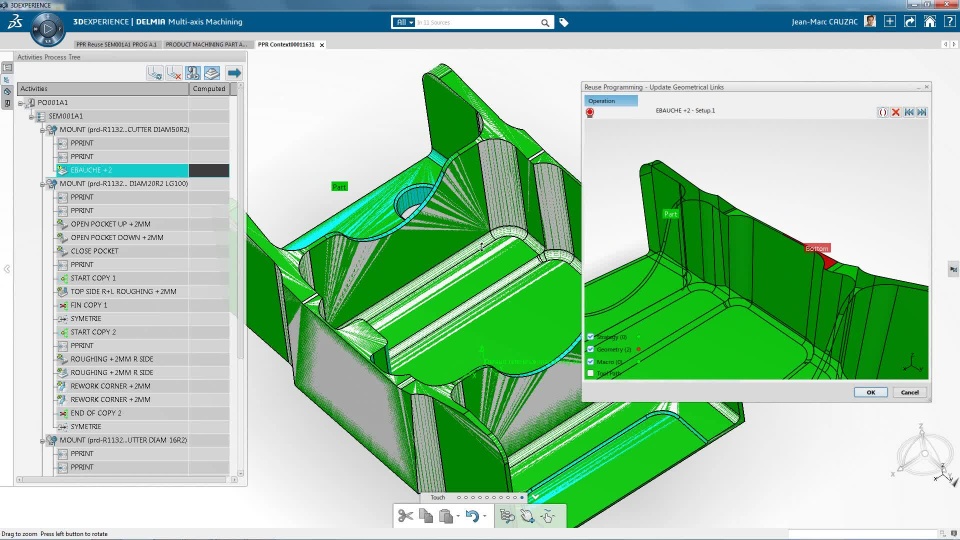

Here is the first post related to new enhancements delivered in the last release of DELMIA Machining : 3DEXPERIENCE R2015x
Reuse Programming is the capability to reuse an already existing NC Program (operation, machine, tools, ...) on a new product with a wizard assistant that will help the end user to fill the missing information. This capability will reduce programming time for similar parts and avoid errors by reusing an already validated NC program
