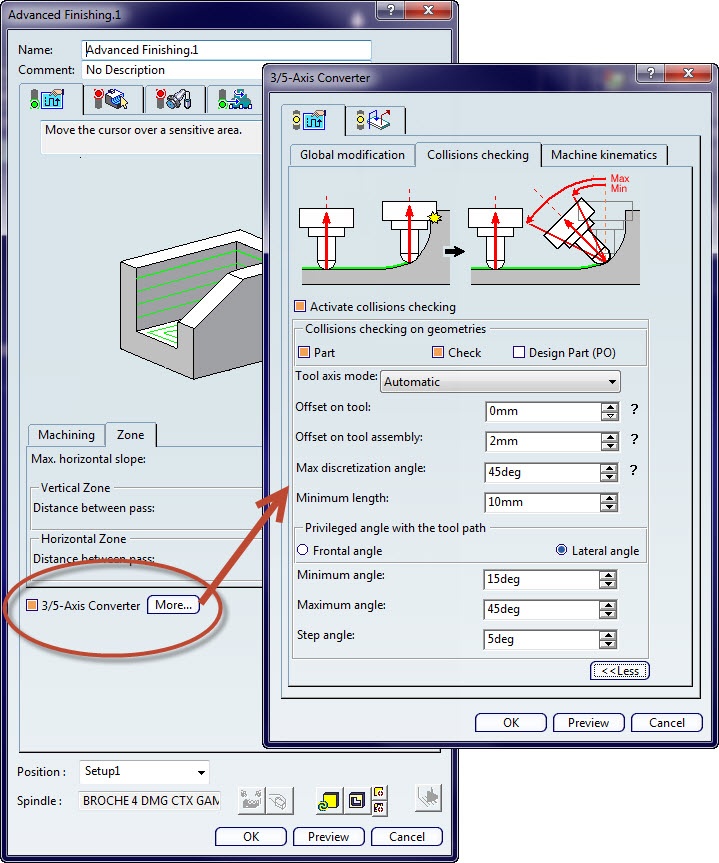

V62013x Highlight 8: Advance Finishing Operation now has 3 to 5 converter !
In V62013x, Advanced Finishing Operation has the 3-to 5 axis converter built into the Operation definition panel. This reduces significant programming time especially for mold and die programmers from having to manually define tool axis motion strategies at shoulders and corners to avoid clash. Now,  with this enhancement,  a simple option checked ON with optional parameters defined , the system will automatically compute 5-axis moves where applicable on the geometry and eliminated potential clashes. The value to the programmer is clearly with improved productivity.
