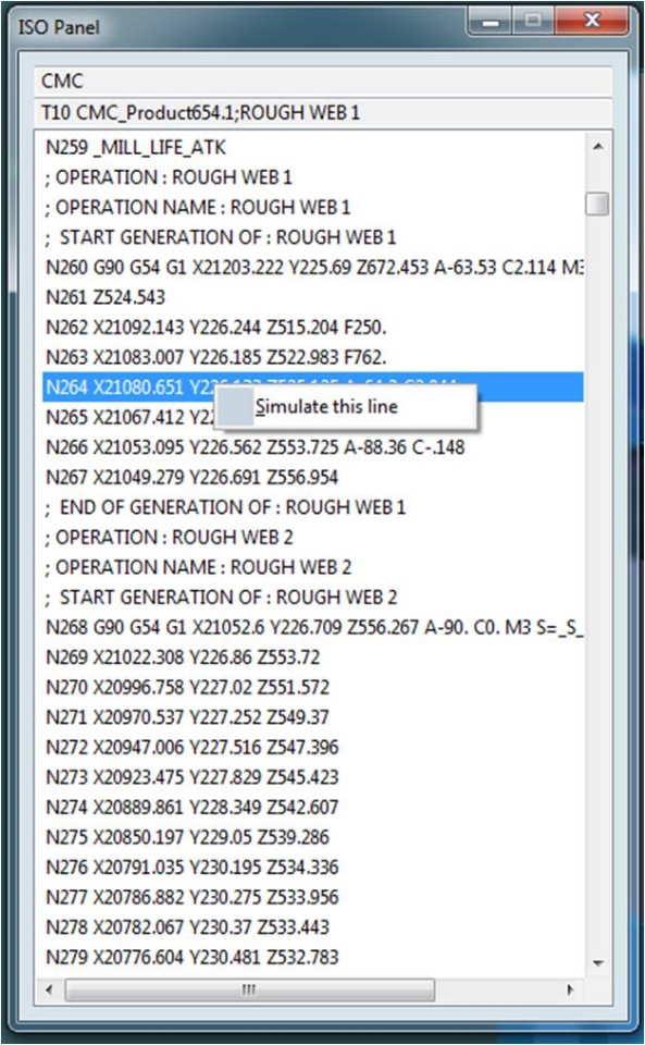

V62013x Highlight 6: Simulate a SINGLE NC CODE Line in your program !!
V62013x offers a whole lot of flexibility to the programmer in dissecting his NC Program and analyze any NC Code line in the program WHEREVER THEY EXIST. There is no need to restart simulation from start to validate a NC Code line. Just right click on the NC Line in the panel and select  'SIMULATE THIS LINE' as seen in this picture below.
