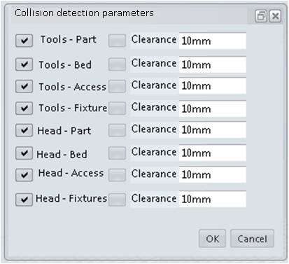

V62013x offers a quick way to define and set-up collision queues with a template like wizzard as seen below. This eliminates the traditional need to manually define queues by picking each and every part that the collisions need to be checked for. This enhancement  helps reduce programming and simulation validation process time.  The collision  queue is remembered by the system for quicker access and set-up the next time user loads up a cell for programming.

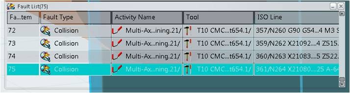

The collision fault report is enhanced to detail  'what collided with what' , the NC Code line number, Machining Operations and the cutting tool information for quick and easy back-tracking to the tool path operation definition for for quick fixing of the issue reported.

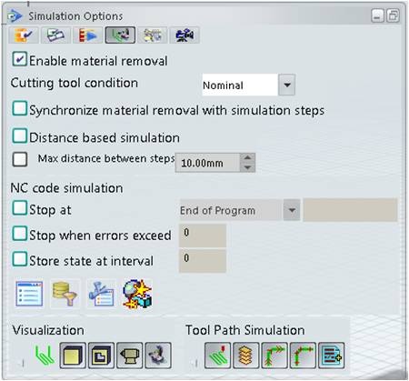

The INTEGRATED PROGRAMMING, SIMULATION AND VALIDATION  EXPERIENCE for the user is smooth without having to switch any environments of workbenches. This saves significant time. Pictures below illustrate the new capabilities. Additional details on collision analysis will be posted on another highlight.
