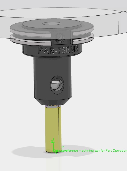

Tooling in 3Dx
Tooling in 3Dx is great, assembling a tool is easy. You can have one holder for multiple tools or vise versa. Operators on the floor can see exactly what they need. Just be very careful when importing your tools from V5. It works but only import what you need then assemble them in 3Dx
