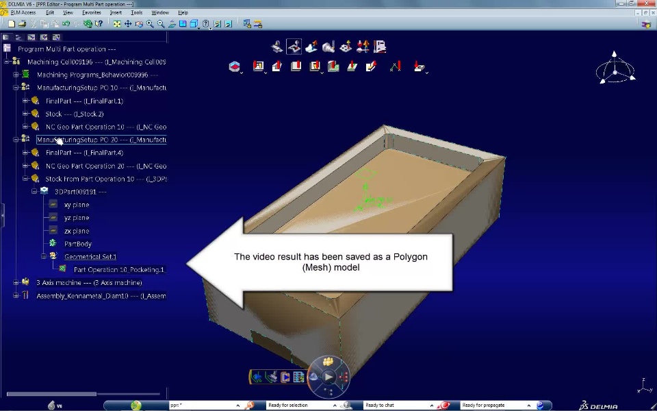

The way to manage the result of a Material Removal Simulation associated to a first Part Operation then to reuse it as the stock of the next Part Operation has changed in V6. This video illustrates how to do that.
The result is no more a CGR model like in V5 but a Polygon (Mesh) included in a 3DPart, that is more standard format for our design products to work on it if needed. On this you can performed Measure, Analysis, ... This 3DPart also includes 3 planes & Axis system that will help the user to position the stock in the new manufacturing Setup.
