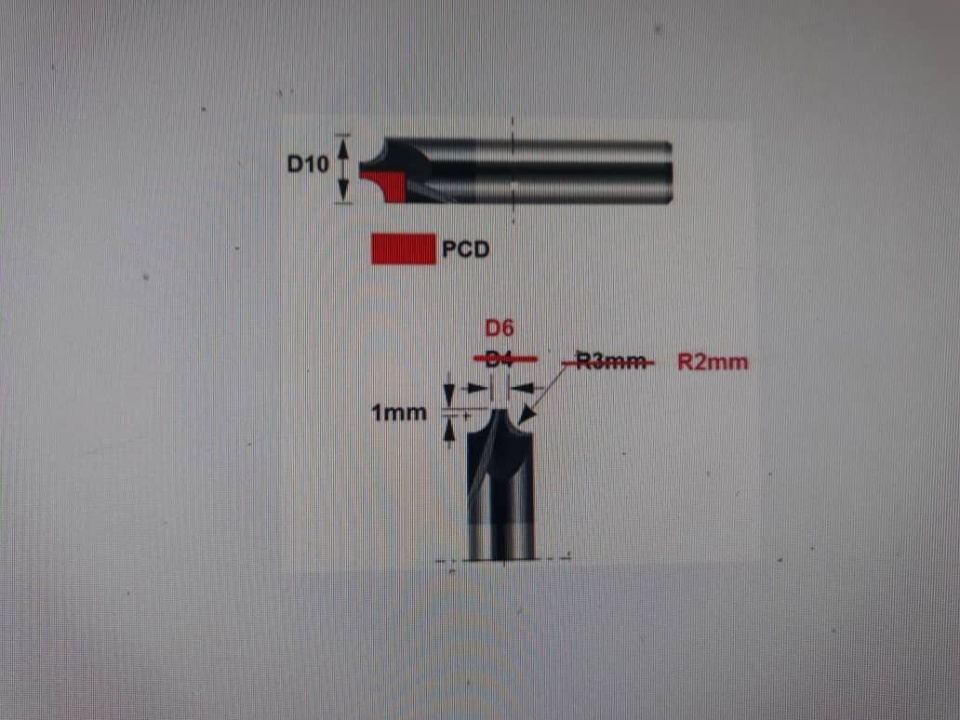

Recently, I received a query from a user regarding to radius milling in Advanced Machining. They are trying to use Corner Rounding Milling Cutter to do the job but could not find any means in defining the tool inside virtual environment.
Can someone guide me as to how can we define this tool?
Edit :: For now, I guided them into using Ball Milling Cutter tool and using Isoparametric Milling function in Advanced Machining
