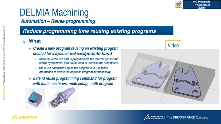

In the R2018x release, the Reuse programming functionality has been enhanced to accommodate the Opposite Hand programming parts. In the original NC program created for a part, you will add additional information about the behavior of the NC program that will be created automatically for the opposite handpiece.
Parameters such as Reverse Approach / Retract macros, Invert Cutting Conditions, Change Sequence of Operations, To Do, ... are added to the original program in such way that the automatic opposite hand program creation will take them into account.
The programming time is greatly reduced by this feature and even more when changes are made to the original program because the opposite hand will be created again automatically.
