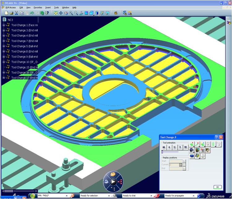

- process chain for a structur part

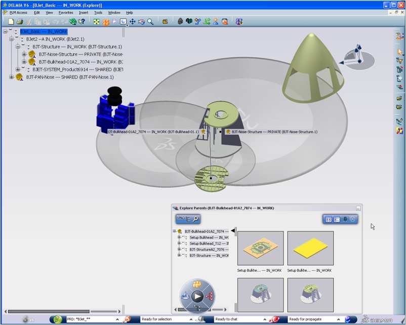

- search the part (radar unit), show in the navigation window all data (from the structur part to thePPRContext included tools

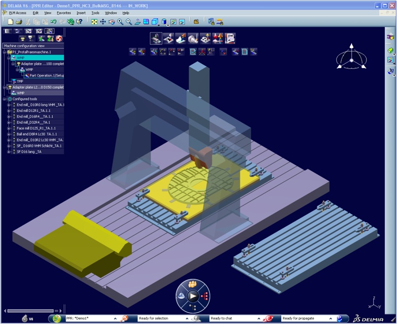

- prepare the part operation
Define NC-Program - Setup

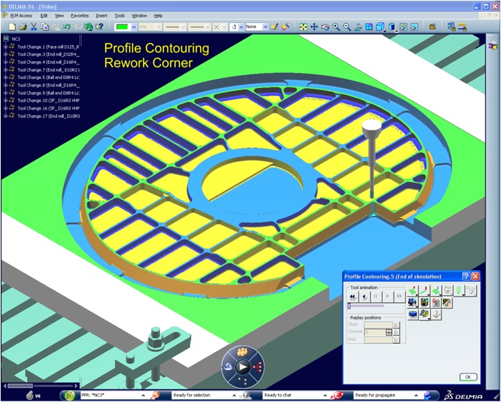

- use deferent machining operation to mill the part from roughing to finishing

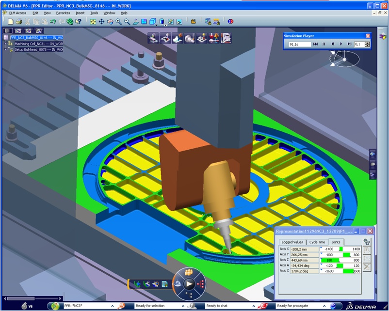

- Simulate the result with machining tool simulation.
