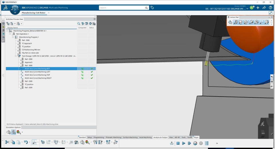

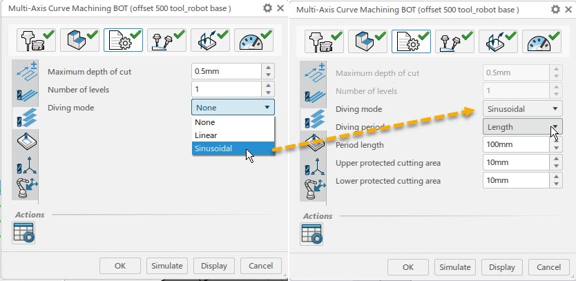

With the last CLOUD update (FD02) you have a new mode in 5 axis curve Machining (Sinusoidal). It is very powerful for composite milling to preserve your tool and increase its time life.
See a short video result on aero composite part (8 meters) . Workcell with a robot on a rail
