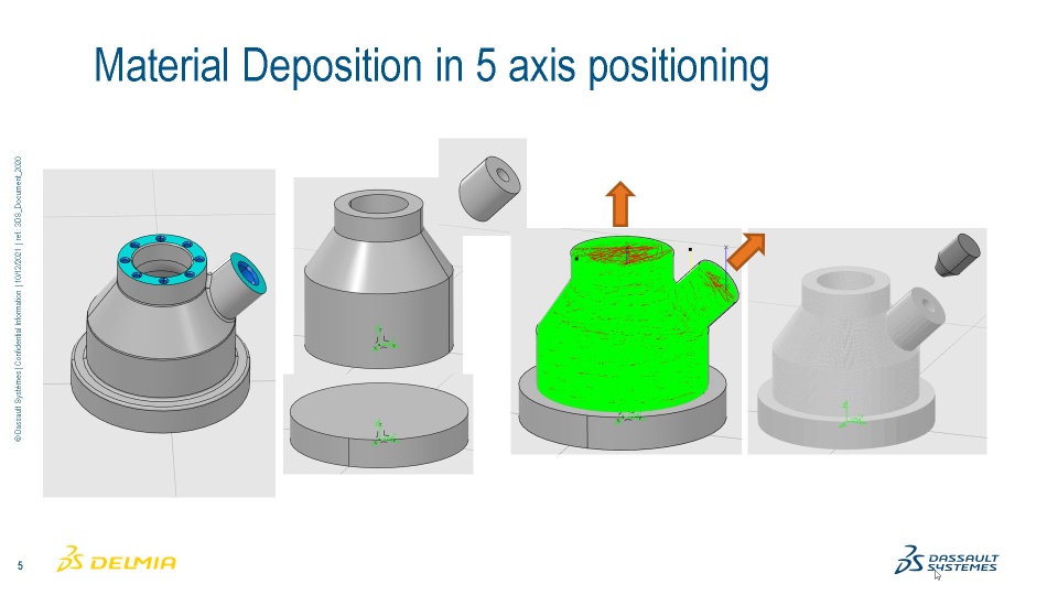

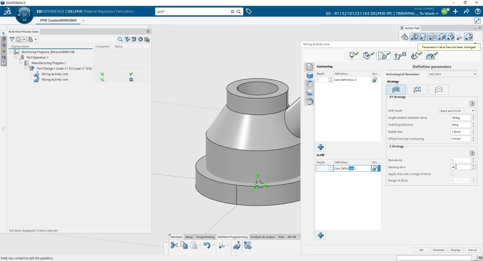

It is now possible to define slicing operation in 5 axis positioning mode to produce this kind of part.
A new parameter is available to define the axis orientation to compute the laser path. See the simple case in video
