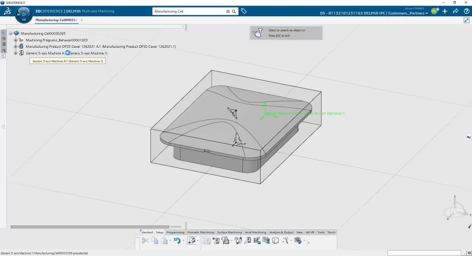

Is it possible and How create a multi PO manufacturing cell ?
I have receive several time this question from CATIA V5 users.

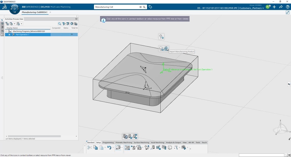

Of course, in 3DEXPERIENCE, it still possible to create a manufacturing cell with several PO, but the way to create it is a little bit different and there is more capabilities
  1. It is mandatory to have one manufacturing product for each PO (if it is the “same”, you load two times to have two instances)
  2. It is possible to manage several machines
I propose in the pdf to describe the 2 methodo and a short video to illustrate how to create the manufcell for methodo 1 or 2.
On my side I prefer the methodo2, but It seems that V5 customer like also the 1 (more closed to the V5)
Methodology ​​​​​​​ R2022x
